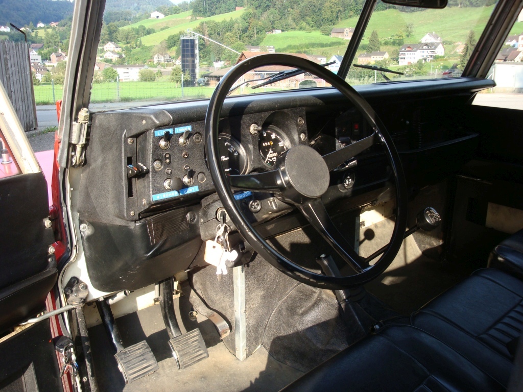

Additionally, there is one gear lever, with a hi-lo selector by your left ankle (if it's RHD, not sure if it is LHD). There are not red and yellow gear levers.
Here is a picture of the inside of a LHD 109 V8.
The rear differential should be a Salisbury, which has a much larger housing than the standard series III diff.
