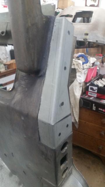

Back to the bulkhead then. Top corner first. The YRM panels are only £19 for the pair...
... so seemed pointless trying to make my own even though I only need a small section...

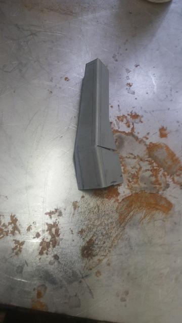

I cut the top corner piece and fettled to fit...
...then it was weldup and grind

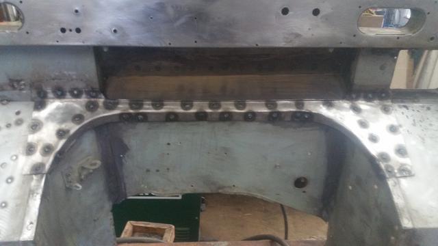

Next, time to fit that strengthening piece I'd made when I started. Drilled it for plug welding and checked for fit...
...then did the welding
...and then the cleanup

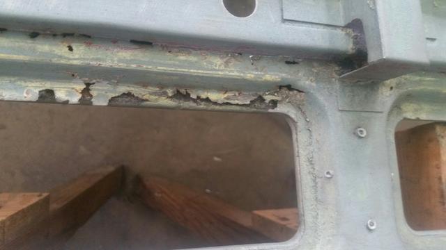

Next job, the rusty vent surround. First off, the top rail was a bit out of shape and dented in places. There's damage including old grinder and hammer marks. God only knows what whoever did that thought they were doing. I spent a bit of time with hammer and dolly and put it right.
Started with this section
I decided to take out the rotted sections and replace with new steel. I did consider trying to source a replacement top rail but that would probably risk more than I gain, the rot is localised and so should be easy enough to deal with in sections, so out with section one

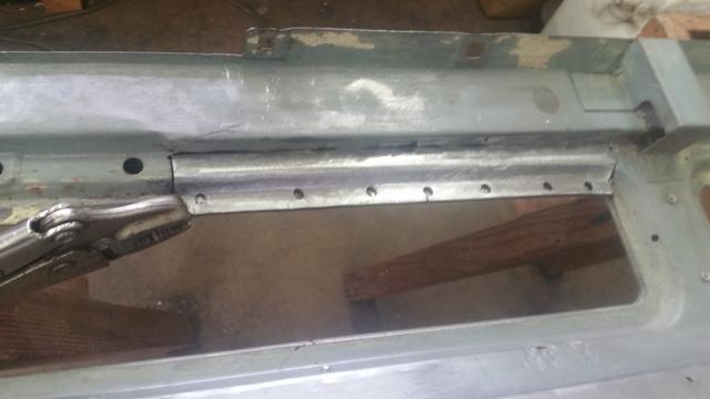

I then made up a replacement section...
...and welded n place

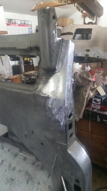

Next, the bubbling and rot on RH top corner
Same old story when you reveal what's hiding underneath
Clean it up and treat...
...then patch in new steel and clean up

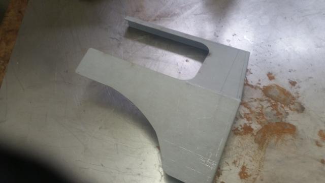

...make a piece for the corner...
...and weld it in
