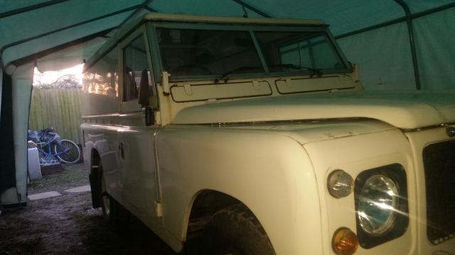

Took delivery of garage tent, so managed to put it up and get the vehicle under cover. I got the 20x12 foot garage so should be ample space to work. It's freezing here at the moment so not sure how much spannering I'll be doing, but hopefully can make a start now I have shelter.

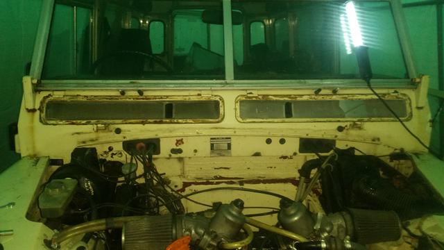

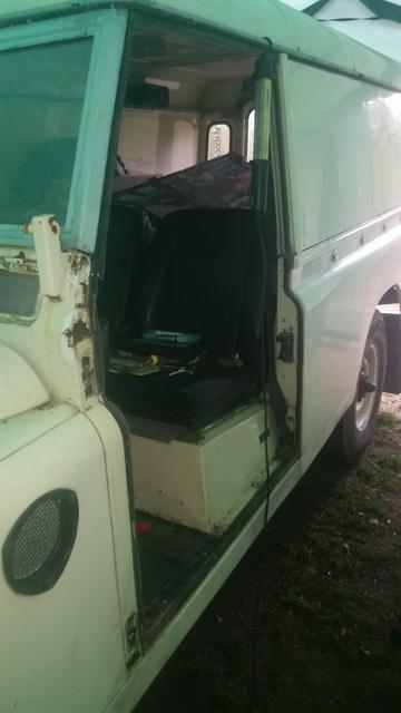

Took the first step and started the strip down. I want to remove and sort out the bulkhead first, so LH door off, then the vents. Not a great deal done yet but it's a start.
I've ordered some lighting for the workspace as it's a bit dim in there at the moment.

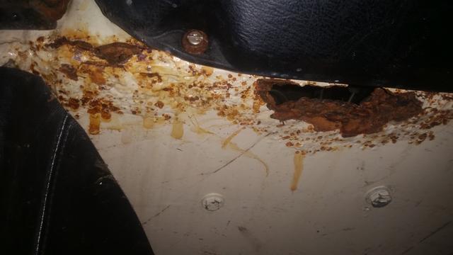

The rot at the top corners is typical but should be easy enough to repair.

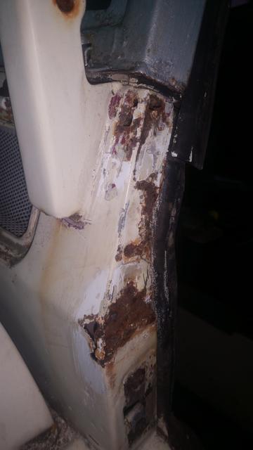

There's also work to do at the base of the pillar

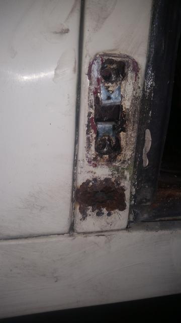

There are two areas of the LH footwell that have gone through. I'll either patch or replace the footwells completely.
Small hole to air your feet

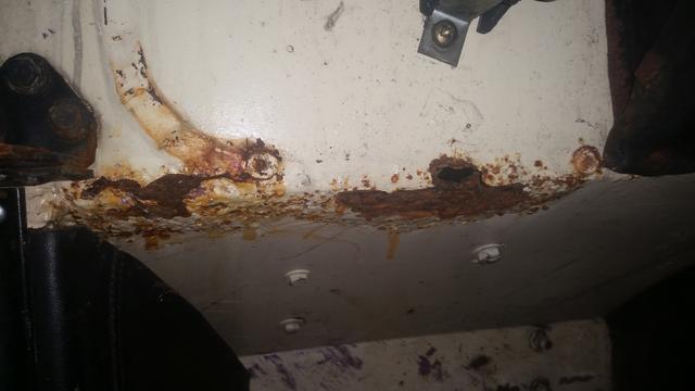

The worst of the rot is at the top at the seam (like they all suffer). I'll remove the dash corner cover and have a closer look inside.

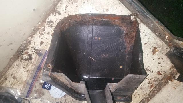

The cover is a bit of a mess though, I'll be needing/making a new one of them.

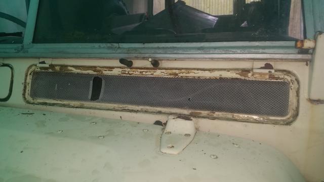

Fortunately, there is no rot around the vents. For some reason, I thought there was going to be work to do on these as some rust flakes came off when I first inspected the vehicle; not the vents though apparantly. A bit puzzled but actually relieved.
So carried on in the fading light and took the other vent and bonnet off, but that's it for now.
It is obvious that she had a replacement bulkhead when the chassis was replaced; It's a different colour under the now flaking paint (poor paint job). Shame it wasn't a galvanised one like the chassis, would have saved me a lot of work. However, it does look like the rot has not gotten too bad yet, so fingers crossed, I should be able to repair it relatively easily.
