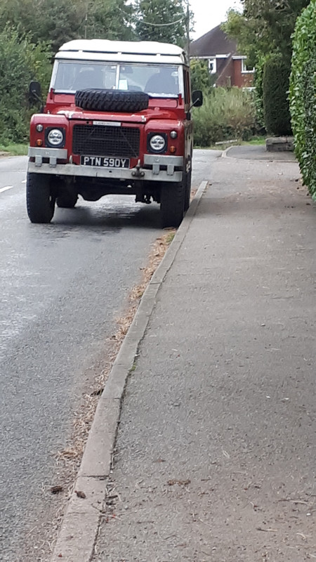

Alice update.
Still rolling along, now have covered just over 36,000 miles since I returned her to the road. I still have what seems like a never ending list of things to do, the most pertanent one being to try and find where water is getting in through the roof. The 'internal gutter' which forms the join between the sides and the roof I recon will hold about 2 pints of water (well that's what is seems like when you apply the brakes and you get a free cold shower!!!)
Mechanically everything is still sound, her body work needs a good going over with a colour restorer sometime as she's looking a bit dull. Now the british summer has arrived, I love driving along with all the vents open and the V8 sound track for company, just crusin along........
