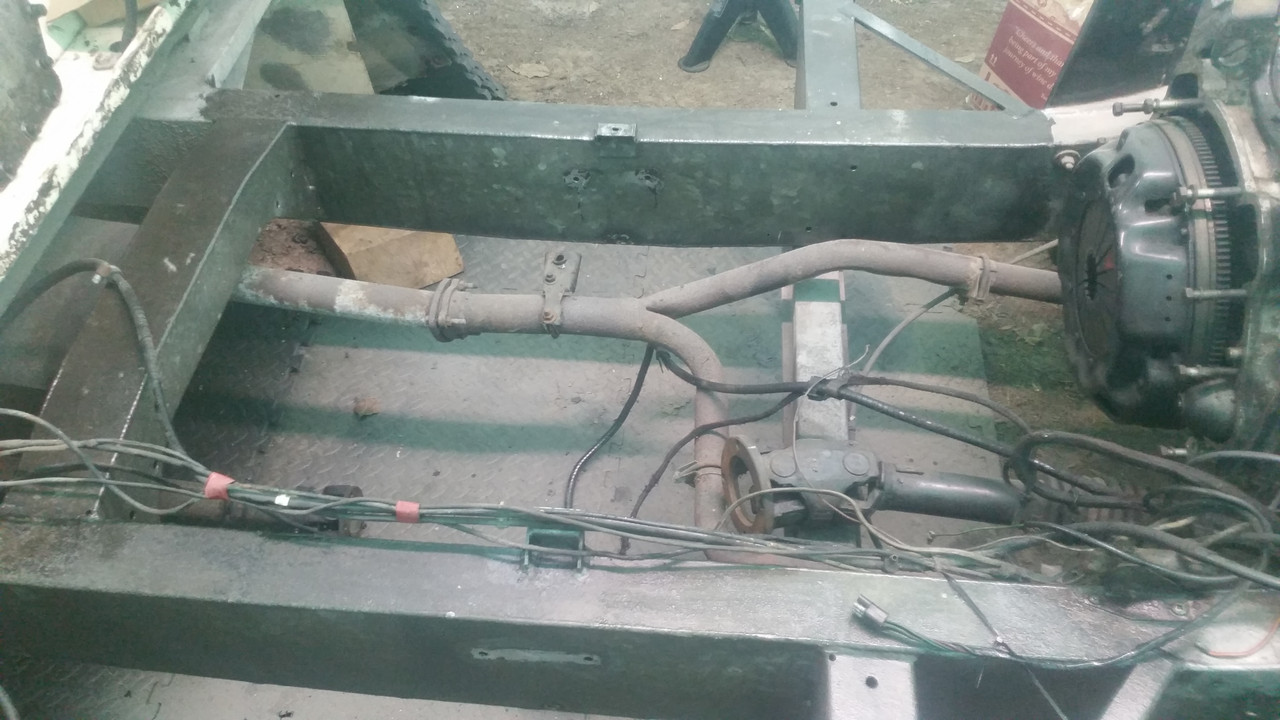

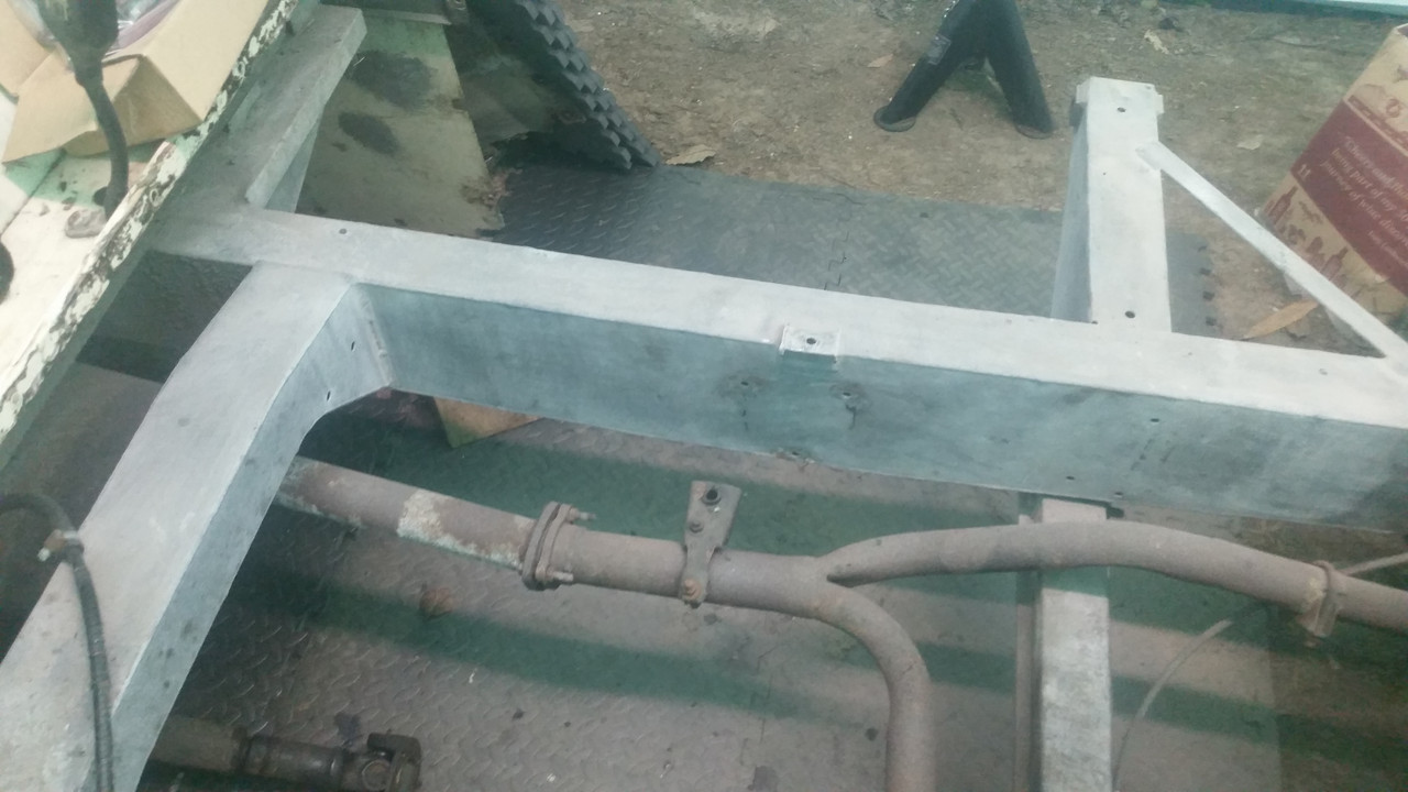

Pressed on today.
I decided to tidy up the chassis ready to refit the gearbox. The galvanised chassis is like new under a few years of grime. I already gave it a pressure washer before removing the gearbox, but it looked a bit dirty still, so gave it a wire brush and then painted it with some oil. I figure a bit of waterproofing can only be a good thing though strictly speaking, quite unnecessary.
With a bit of oil...

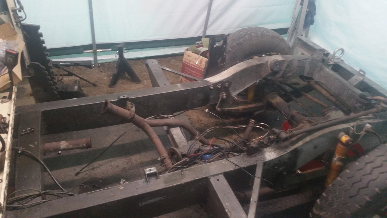

Having started, I thought best to carry on and have the engine out too. So radiator first.
Viscous fan...
...and after a lot of contorting and knuckle skinning, got the exhaust, earth strap, alternator, breathers, fuel line, etc. freed, set up the crane amd started the engine lift
With the V8 out of the way I'll finish off tidying the chassis and sort brake lines, etc.

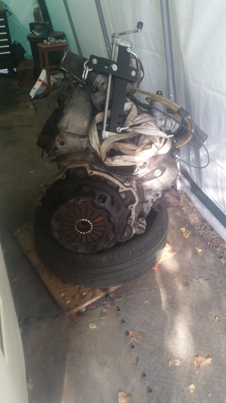

The V8 is on the dolly ready for overhaul.

Not been much progress since lifting the engine, it's been sat on the dolly in the way, so really needed to shift it until I can work on it. I want it in my workshop but how to get it up over the step? Came up with the one man two stage shift-it plan.
Put a board covered pallet in front of the workshop door step and used the crane to lift the engine up off the dolly, put the dolly on the pallet, and lower the engine back onto the dolly which can now be wheeled straight into the workshop.
What a faff! Not so easy shifting heavy stuff on your todd.
