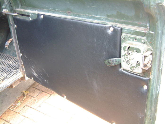

Just depends on how flash you want them to be I guess. They are very easy to make. Some vinyl, hardboard, closed cell foam (if you want the top part), some glue and screws and an afternoon of happy craftwork.
Door cards

Thanks guys; I think I'll try Alan's idea and attempt to make my own in a sticky back plastic/empty washing-up liquid bottle Blue Peter fashion ... !
Posted: Wed Jul 07, 2010 1:13 am
by disco2hse
That's what I did. One thing that improves them a bit is to stick 3mm foam to the hardboard before putting on the vinyl. Cuts down on a lot of noise and keeps in a lot of warmth.
